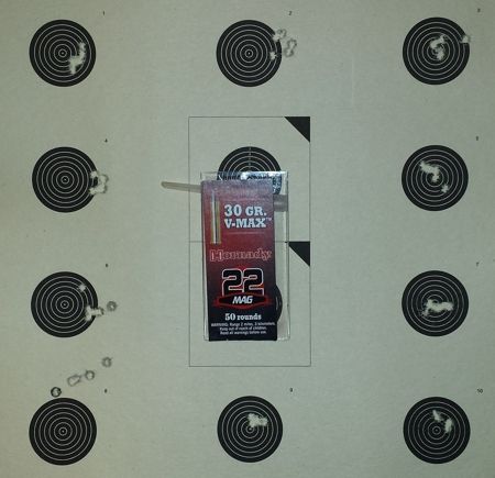

Range report today 05Jun15, Remington 547C .22WMR, 20X scope with 3 adjustments, overcast, low wind, 62F, benched, 50 yards, 10 5X groups, with Hornady 30 gr V-Max load. Barrel was very clean, solvent, brush, patches, trying to see if this helped getting more consistency with the WMR. Seemed to help some, the first two groups, lower left, were large, but then the groups tightened up. Very good until the last group, upper right, the last shot opened it up to right. Does anyone get 10 group consistency at 50 yards, with what ammo and rifle(s) ? Second target today with the Rem Premier 33 gr accutip-v was not as good.
That's about normal for the majority of WMR in my opinion.
I've had a couple and have a couple of friends who have them.
My current 93FVSS, which has been tweaked to the point that my $300 gun now is worth about $1400 is the best of the bunch.
I have no problem getting one or two sub 1" groups at 100m (with the Hornady, which is its favorite) in a session.
Thing is there will also be one or two 2" groups as well :( with the majority sitting around 1.5".
My buddy with the same gun in .17HMR sits there and shoots slightly under an inch groups one after the other.
I have experienced the unexplainable flyer more in the 22 Mag than any other caliber. In my opinion, you are doing your testing correctly. 10 five shot groups lets you know exactly what to expect. I beleive the QC on the 22 Mag ammo allows the occasional flyer. When someone claims a sub moa 22 Mag, they are DEFINITELY not taking the average of 10 five shot groups, they are probably picking the best one or two groups they have ever shot.
I have done exhaustive testing of my Anschutz 22 Mag with at least 10 different main stream ammo types. The best accuracy is from the Remington 33 grain, the Hornady Vmax was only average. There were unexplained flyers from all ammo types. Although there has been only 1 unexplained flyer from the Remington 33 grain. That round when fired gave a very stiff bolt lift and the round was 2" outside the group at 100 yards. This was out of 100 rounds of testing with that ammo.
So I dont think it is possible to fire 10 five shot groups 2 times in a row (100 rounds) without having at least 1 unexplained flyer, and probably much more depending on the ammo type.

You are absolutely right that one group, or even two or three, averaging a certain size does not establish the accuracy potential of that load with that rifle. And I agree that many reports of "MOA," "covered by a dime," etc., are nothing more than the best group shot with the rifle. Some folks think that a gun should be understood to be as accurate as its best group, under the assumption that, if it shot a group this small once, it is capable of that in general. However, any rifle will turn in the occasional eye-popping group. With that group, conditions were optimal, your wiggles coincided with the guns wobbles for 5 shots, and all five went into 1.0".
Averages of several groups are essential to determine a rifle's accuracy understood to be with that particular ammo on that day with all conditions that existed that day, and with your bench technique what it was that day. The mean of 10 5-shot groups is pretty definitive. The testing staff of the NRA's American Rifleman used to report the average of 5 consecutive 5-shot groups (mainly tests of rifles with factory ammunition), and I might settle for 5-8 groups being used in the average, with all groups shot being included in the average (i.e., no cherry-picking the best groups out of a larger number).

I wish more people understood this South Pender.
Yesterday was a perfect example.
Six, 5 shot groups at 100m (where I was 'really trying').
One a little under an inch...four between 1.25 and 1.5" and one about a hair over 2".
I know too many people who would be crowing that they consider themselves (and their gun) to be 1" shooters.
I figure I've got a 1.5" gun, and am completely happy with that.
Ecstatic with the 1" group.
Tearing my hair out at the 2" group ;)
